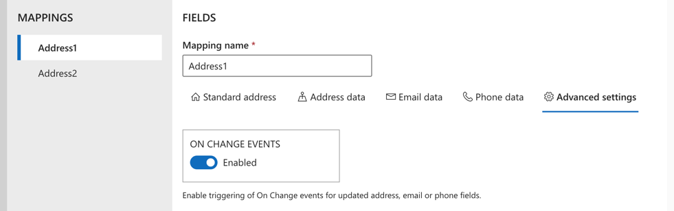

On Change event handlers can be configured by a user in the form editor for any field. They are triggered when the user makes a manual change in a form field, however they are not triggered by default if the change to the form field is made programmatically, such as when an address is selected and formatted. For this to happen, On Change events must first be enabled.
Power Apps interface only
