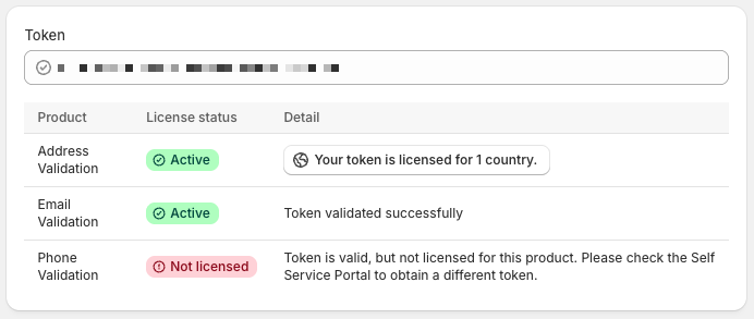

You will need to provide your Experian Address Validation API authentication token. If you don’t already have a token, please visit the Self Service Portal to obtain one or contact one of our regional sales teams.
The token will be validated on entry and if successful be marked with an Active badge.
If the token is valid and the app detects a change to your licensed datasets, you will be prompted to review your Datasets configuration.
If you experience any errors when setting your token please refer to our troubleshooting guide.

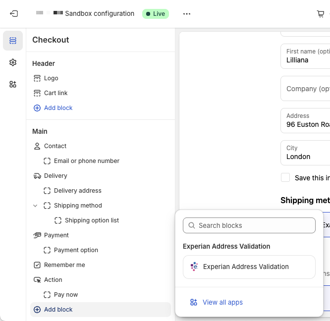

Select Checkout from the page selector in the top bar of the editor.
Within the Sections sidebar, scroll to the Main section of Checkout and click Add block.
Select the Experian Address Validation block and it will automatically be added beneath the delivery address.

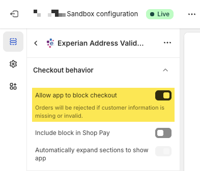

Under Checkout behavior in the sidebar ensure Allow app to block checkout is enabled.
Ignore the Block settings as everything is controlled from the dedicated Settings app.
Click Save.

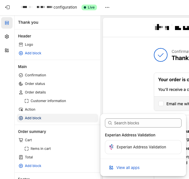

Select Thank you from the page selector in the top bar of the editor.
Within the Sections sidebar, scroll to the Main section of Thank you and click Add block.
Select the Experian Address Validation block and it will automatically be added beneath the Confirmation message.
Click Save.
