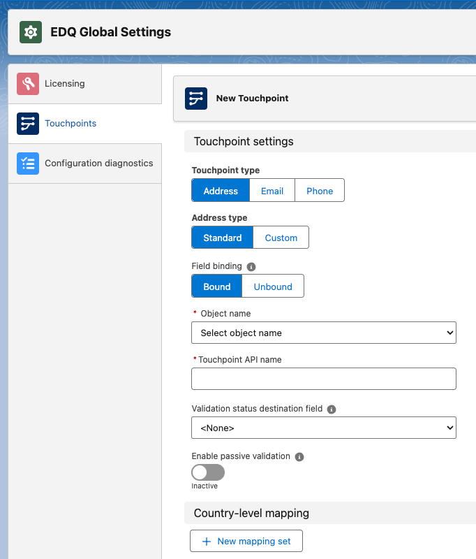

  3. Click the New button found in the top right to create a new Touchpoint configuration for your Salesforce object.
  4. Choose whether you want to create a Touchpoint for a Standard address field (including the new Custom Address Field) or a set of Custom fields used to represent an address:
    • For standard address fields you just need to choose the object and then select from the list of dynamically generated target address fields found within that object.
    • For custom fields you can refer to the additional instructions on configuring address Touchpoints with custom fields to understand how these are configured.
  5. Set the optional destination field for the validation status. By default the validation status is stored in a separate EDQ Log object, which happens in a trigger after the object is saved. If action needs to be taken based on the validation status before saving, then we offer the option of storing the status in a destination field on the record itself. Refer to the EDQ Log custom object guide for details on the possible status values.
  6. Activate the optional Passive validation feature should you wish to use it.
    New Touchpoint
